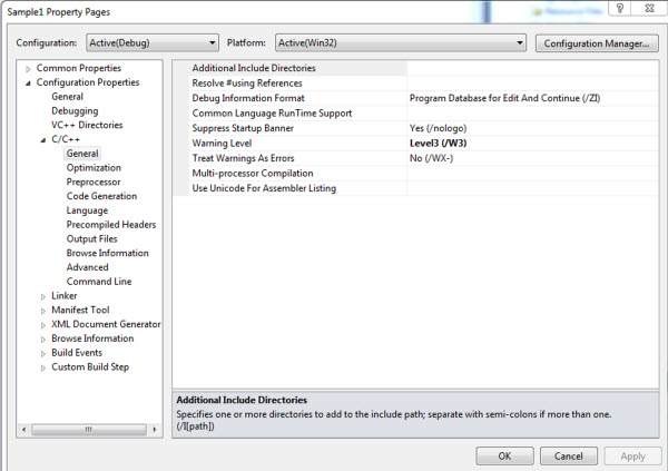

  3. Select PROJECT > Properties. The Property Pages dialog appears.
  4. In the property tree on the left of the Property Pages dialog, choose Configuration Properties > C/C++ > General.

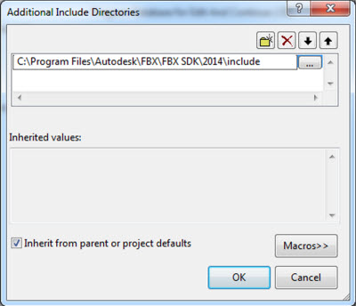

  5. In the properties sheet on the right of the dialog, select <Edit..> in the Additional Include Directories drop-down box. The Additional Include Directories dialog appears.
  6. In the list box on the top of the Additional Include Directories dialog, click the top blank line until you see a control to browse for directories.
  7. Use this control to add the full path for the <yourFBXSDKpath>\include directory and click OK.

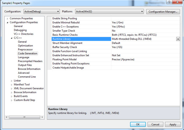

  8. In the tree on the left of the Property Pages dialog, select Code Generation.
  1. In the property sheet on the right, choose the type of run-time library for your project in the Runtime Library drop-down box. The list corresponds to the Visual C++ compiler options: /MD, /MDd,/MT, /MTd, and so on. Not all compiler options are available for all versions of Visual Studio (see Configuring the FBX SDK for Windows).
