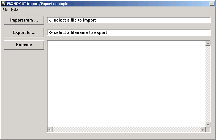

User Interface
User interface to ImportExport tutorial program. Messages appear in the large textbox beside the Execute button.
