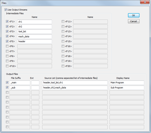

Files dialog
Use the Files dialog to split the nc file into multiple intermediate files, and then combine these intermediate files in different ways to create multiple output files.
For example, you can use this to group wait codes together and output them at a single point in the post, and avoid mismatched wait codes when outputting to multiple channels.
File management is required for one-pass posting.
To use multiple output streams for the nc code:
  1. In XBUILD, select the CNC-Info > Manage Files menu option to display the Files dialog.
  2. Select Use Output Streams.
  3. Under Intermediate Files, select the intermediate nc files you want to create and enter a Name.
    Each intermediate file has a number, which you can use to send individual lines of the nc code into different intermediate files.
  4. Under Output Files, specify the final nc files you want to create and output from FeatureCAM.
    1. Enter the File Suffix and Ext to specify the suffix and extension that will be applied to the file you output.
    2. Under Source List, specify the intermediate files you want to combine to create the output file.
      In the example above, the NC Code output file includes all the intermediate streams, and the ToolList output file includes only the tool list intermediate file.
    3. Enter the Display Name. This is the name of the nc file when displayed in the NC Code tab of the Results window in FeatureCAM

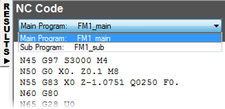

  6. Simulate the toolpaths in FeatureCAM.
  7. In the NC Code tab of the Results window, select an output file in the list to display the nc code in the output file.
  8. Use the Save NC dialog to save the nc code output files.
