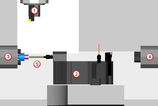

This example shows a drill tool being used to cut a Hole feature on the main spindle:
Upper turret
Lower turret, horizontal
Main spindle
Sub spindle
Tool

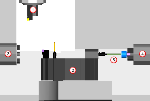

The tool number is then offset, the horizontal turret is rotated and the same tool is used to cut a hole on the sub spindle:
