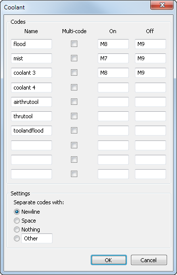

To access the
Coolant dialog, select
CNC-Info > Coolant from the menu.
You can specify up to 10 coolant types in the
Coolant dialog, for example:
To specify the coolant details:
- Under
Codes, enter the
Name of the coolant.
- Enter the
On and
Off codes, or select
Multi-code and click
Configure to use
multi-code coolant, where you can specify different on and off codes depending on the turret and tool being used.
- Under
Separate codes with, select an option to determine how to separate multiple codes when they are used together in the NC code.
Newline — Select this option to use a line break between coolant codes in the NC code.
Space — Select this option to use a space between coolant codes in the NC code.
Nothing — Select this option to not separate coolant codes in the NC code.
Other — Select this option and enter a string to use between coolant codes in the NC code.
Note: This applies to the
<COOLANT> and
<CANCEL-COOL> reserved words only.
- Click
OK to close the dialog.
