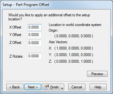

Setup - Part Program Offset
This page enables you to translate the location of the Setup. One reason to translate the Setup is to model the extra stock on top of the part that is removed during a facing operation. You may also want to translate it to a location that you cannot easily snap to.
To complete this page:
  1. If you want to translate the stock, enter the amount to offset the stock as the X Offset, Y Offset, and/or Z Offset.
  2. Click the Preview button if you want to review the new location of the Setup.
  3. Click Next to open the Setup - Simulation information page, or click Finish.
