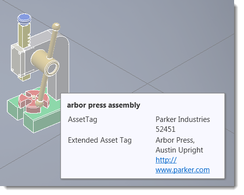

Both asset tags and descriptors may contain multiple lines of text. Text appears by hovering the cursor over the asset.

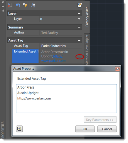

  1. On the ribbon, click Palettes and select Factory Properties.
  2. In the layout, select the asset for which you want to create an asset tag. The asset properties appear in the Factory Properties palette.
  3. Type the information in the Asset Tag field. If the information does not fit in the field, click the ellipses (...) to open the Asset Tag window and enter the text. An Extended Asset Tag field is also available for additional information. You can include Internet links in your text.
  4. Click the Update icon at the top of the palette to apply the tag to the asset.
  5. Hover your cursor over the asset in the layout to view the new tag information.
