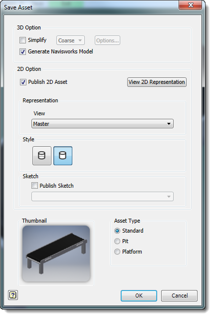

  6. Click Save. The Save Asset dialog appears:
  7. Select Simplify to publish an assembly as a single part or to save the part as mesh, and then choose a setting from the drop-down menu. Selecting Simplify can improve performance and simplify file management because fewer files are created.
    If this is an assembly, click Options to shrinkwrap the assembly or save it as mesh. Parts can only be saved as mesh.
    For detailed information about how to complete the shrinkwrap fields, see Shrinkwrap Assemblies Dialog Box in the Inventor help. For information about the Save as Mesh fields, see Save As Export Options Reference in the Inventor help.
  8. Select the Generate Navisworks Model checkbox if you use Navisworks and want to generate a Navisworks compatible model when publishing an asset.
  9. Select the Publish 2D Asset checkbox to publish a 2D drawing (in DWG format) of the asset. Publishing a 2D drawing of a 3D asset creates a 2D asset for use in AutoCAD Factory. The asset is automatically placed in the User Folder of the AutoCAD Factory Asset Browser. Click View 2D Representation to preview a 2D version of the asset.
  10. Select a saved view, or accept the default Master view, from the View drop-down list. Then click the appropriate Style button to choose between a hidden line or non-hidden line representation for the published drawing.
  11. Select the Publish Sketch checkbox if you want to publish a specific sketch from the part or assembly browser of the asset. Select the browser sketch name from the drop-down list.
  12. Select the Asset Type.
  13. Click OK to save changes and publish the asset.
