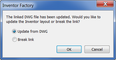

Update from AutoCAD
Use the following procedure to update a 3D factory layout when revisions have been made to the original AutoCAD layout. If the 2D layout is open in AutoCAD, it must first be closed before an update can be performed.
  1. The browser icon for the drawing node will indicate that the original 2D drawing has been revised and the 3D factory layout requires updating.
  2. On the ribbon, click Factory tab Sync Workflows panel Update from AutoCAD .
    Note: As an alternative, right-click the drawing node in the browser and select Update from the pop-up context menu.
    The following occurs:
