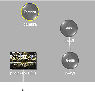

    The Projector node appears in the schematic and a projector icon appears in the scene.
    (a) Projector node  

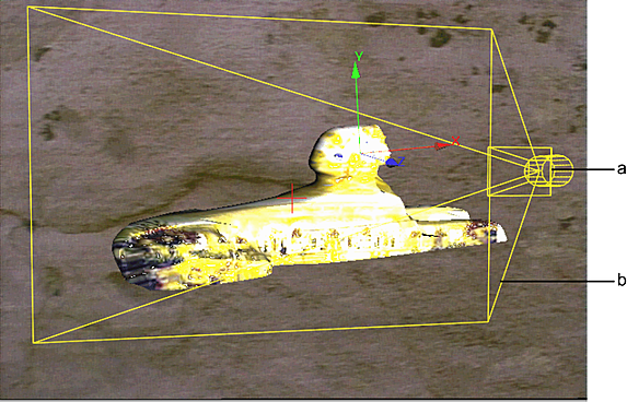

  5. Switch to Camera view to manipulate the projector in the scene using the View box.
    (a) Projector icon  (b) Yellow outline shows the projector field of view  
