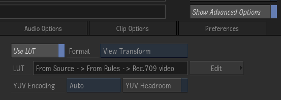

Flame works in an RGB colour space: it needs to translate RGB information back into YUV. This setting ensures that the right encoder is used for this. Specifying the wrong option will result in colour problems upon decoding. Per Recommendation BT. 2020, UHD media should use the Rec. 2020 colour space. But this is rarely the case at the moment: UHD clips still use Rec. 709. The Rec. 2020 option is there is case you need the new standard.
See also: Applying Colour Management to Clips
