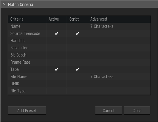

Match Criteria Window
The Match Criteria window enables you to manually select the criteria to use to match segments. It has two modes: Active and Strict.
- Active: Enables the Match Cirteria. When Strict is not selected along with Active, the Advanced column determines the number of characters in the criteria that are required for a Match. You can modify the number of characters used by Name, Tape and File Name when Strict mode is disabled, by changing the corresponding values in the Advanced column.
- Strict: When enabled, the entire string for that criteria must be present for a Match. In Strict mode, the Advanced column is not taken into account.
Source Timecode, Handles, Resolution, Bit Depth, Frame Rate, UMID, and File Type default to Strict mode when activated.
The Match Criteria window can remain open while tending to other parts of the Conform tab. This allows you to modify the Match Criteria and see the update live in the Conform list. Match Criteria are saved when the Close button is pressed and the Match Criteria that were selected when the dialog window was opened are restored when the Cancel button is pressed.
You can save the selected Match Criteria as a preset, by simply clicking the Add Preset button. You can delete presets using the drop-down arrow, to the right of the button.
