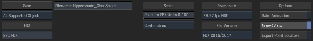

FBX Export Settings
- FBX Mode box
- Select whether to export all supported FBX objects, or only the selected FBX objects.
- File Extension field
- Displays the default extension for the file type selected (in this case, FBX).
- Filename field
- Displays the file name for the exported FBX model. Editable.
- Pixels to FBX Units field
- Displays the scaling factor to apply to the exported FBX file to be used in the 3D application. Use the Units box to select the unit of measurement. Editable.
- Units box
- Select a unit of measurement to apply to the exported FBX file.
- Framerate box
- Select a framerate for the exported FBX file.
- FBX File Version box
- Select which FBX version to export the file to.
- Bake Animation button
- Enable to add a keyframe at every frame of the exported FBX camera file.
- Export Axes button
- Enable to export the animated axes present in the Action scene.
- Export Point Locators button
- Enable to export the 3D point locators created by the Analyzer.
