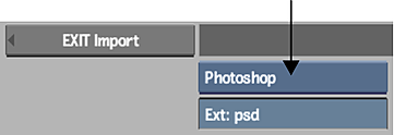

To import a PSD file into Action:
  1. From the Action Node bin, double-click the Import node.
    The file browser appears.
  2. From the Import Type box, select the Photoshop format.
  3. Select a .psd format file.
  4. Click Load.
    The Photoshop file is loaded into Action. Each layer is parented by an axis, and blend modes are maintained. A Batch reel is created to house the images imported in the layers. It is closed by default.
