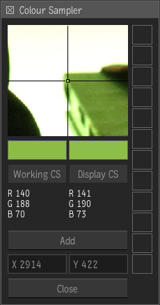

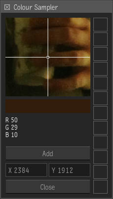

The Colour Sampler
The Colour Sampler enables you to sample colours with precision, while displaying the pixel coordinates, associated to the selected pixel, in realtime, whether the image is static or changes from frame to frame. Sampling colours with the Colour Sampler automatically adds the selected colours to the Colour Picker’s custom colour pots. Hence, the Colour Sampler enables you to sample colours precisely and efficiently and easily build a palette of custom colours, in the Colour Picker.
The Colour Sampler can be opened using a button located next to the zoom controls in a Player / Viewport or via a keyboard shortcut: Alt + Space + C (in all profiles). It is available in all Players / Viewports throughout the application, including the modules with Multiview support.
Note: The Colour Sampler button is deactivated when a non-image view is selected.
The Colour Sampler includes a widget: A red square that turns yellow when placed over a red pixel. The widget is used to determine the pixel you want to sample.
Once the Colour Sampler window is displayed, it remains open until you close it. This makes it possible to change the view or the clip, and to scrub the media and see the same pixel (x/y) coordinates update. This can be useful for colour integrity checks.
Also, when using the Colour Sampler while in multiview and you change the multiview display, the Colour Sampler remains anchored to its original viewport.
You can enable the “Show Display CS Info” option in the Flame User Interface Preferences. Enabling this option adds a second set of RGB values in the Colour Sampler, showing the values after the viewport colour management has been applied. This also adds a read-out of the x/y pixel coordinates.
Use the Add button to add the current colour to the Colours Sampler colour pots, as well as the Colour Picker custom colour pots.
Note: The sampled colour is always that of the Working Colour Space, regardless of whether or not the “Show Display CS Info” option is enabled.
