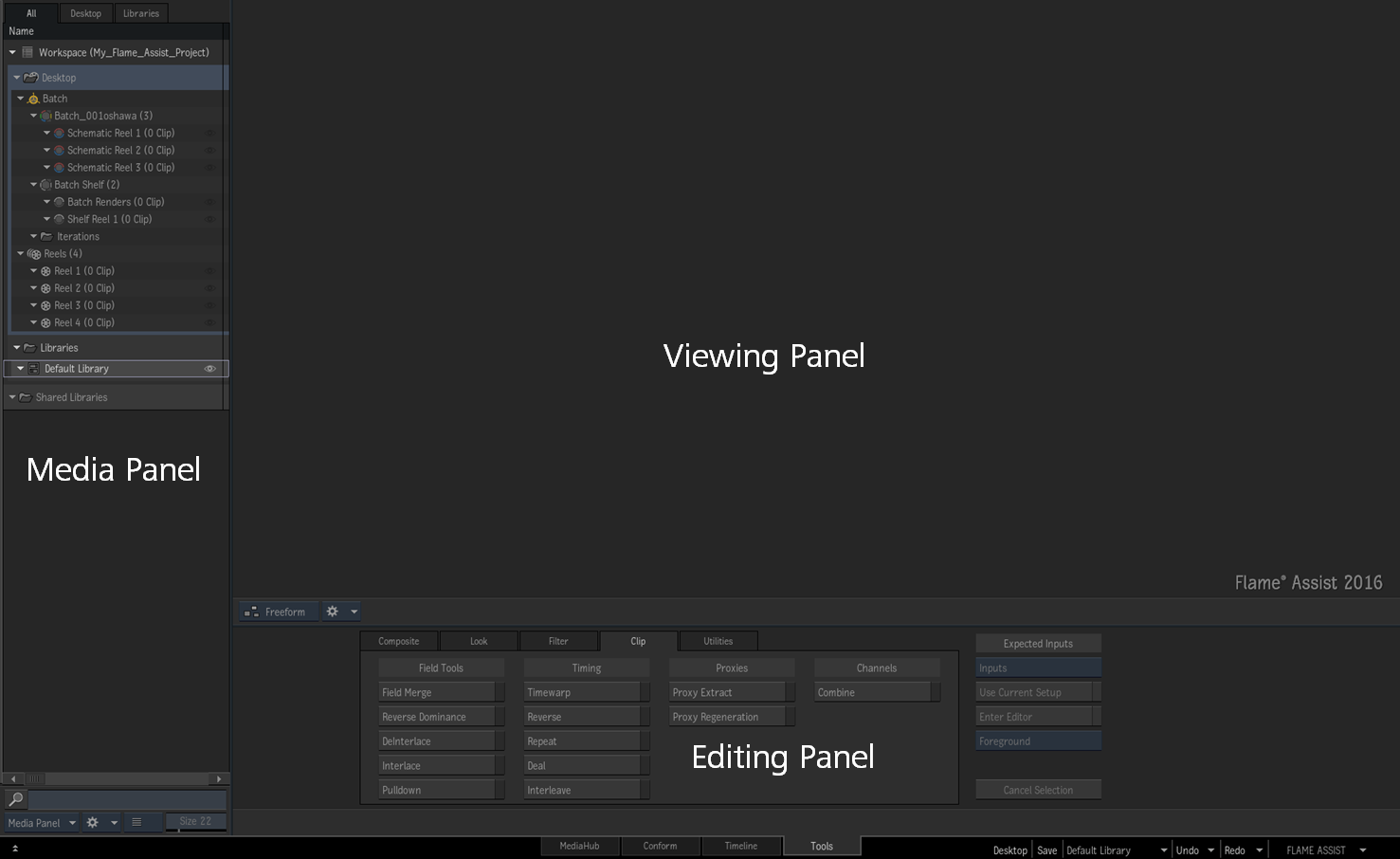

The Workspace is where you accomplish all of your project tasks. The Workspace consists of three panels:
- The Media panel
- The Viewing panel
- The Editing panel
Each panel has its own menu bar, where commands related to the panel can be performed.
At the bottom of the user interface is a series of tabs, which each give quick access to different views. Regardless of the current view, the working environment remains the same.
