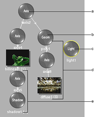

In Action Schematic view, a node exists for all objects in the scene, for example, shadows, lights, and texture maps.
(a) Axis object is the parent of axis 4 and poly1  (b) 3D model  (c) Light source  (d) Diffuse texture applied to the 3D model  (e) Drop shadow of bilinear1  

Surface Nodes
When you add a surface node to the schematic, the node name is displayed with a number in parentheses. The number indicates the media applied to the surface. For example, a bilinear object labeled (1) shows that the bilinear uses the clips from Media 1.
When the resolution and colour space information of the surface is blue, that surface's colour space doesn't match Action's colour space. See Colour Management in Action.
For more information on the relationship between media and surfaces, see Adding Surfaces .
Camera Node
The camera node appears in Schematic view by default and you can link it to any image. Use the camera node to rotate the camera about its own axis, and parent other nodes including shadow, texture, and geometry nodes.
Shadow and Texture Nodes
Shadow and texture nodes each display a single number in parentheses beside the name that indicates the media used for the shadow or texture. For example, a shadow labeled (2) shows that the shadow uses the matte from Media 2.
