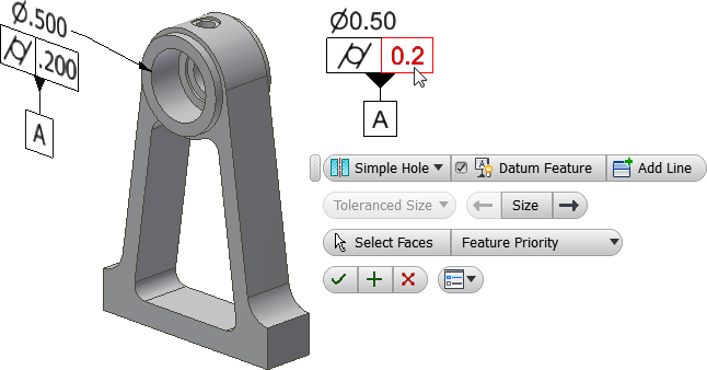

  - On the part ribbon, click
		Annotate tab  Geometric Annotation panel Geometric Annotation panel Tolerance Feature Tolerance Feature . .
- Select the required face or faces, adjust the options if necessary, and then click OK.
- Drag the leader to the required location and then click to place the endpoint of the leader.
		Tip: To change the orientation of the leader, right-click and select Align to Geometry before you place the leader endpoint. You can click an edge or axis to change the orientation.
		  An interactive preview of the tolerance annotation is attached to the minitoolbar. The minitoolbar includes options to select type of geometry or feature, attach a datum identifier, or add a row to the feature control frame. Options suitable for the selected geometry or feature are displayed in the list boxes.
-  Click the elements on the preview to edit properties and values displayed in the annotation.
- Click OK to create the Tolerance Feature.
		 The annotation is added to the Tolerance Features folder in the browser.
