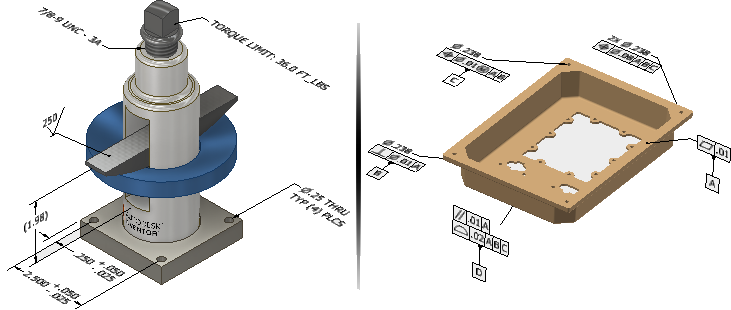

Use general annotations and notes to add 3D annotations to a part or assembly.
In a part file, use the Tolerance Feature command and the General Profile Note to add Geometric Dimensioning & Tolerancing (GD&T) and other manufacturing information to the model.
GD&T annotations on the 3D model describe the tolerances, controls, and allowable variation in the model. The term Model-Based Definition (MBD) refers to a fully defined 3D model. The annotated 3D model is often sent directly to manufacturing to create the physical part.

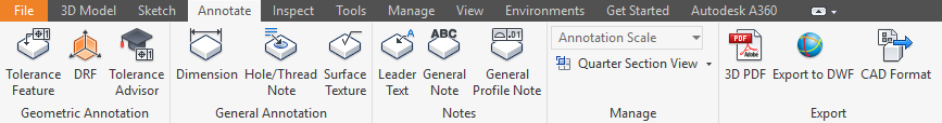

Use commands available on the Annotate tab in a part or assembly file to add 3D annotations to your model.
Use the Tolerance Feature command in a part file to add GD&T annotations to your model. Use the Tolerance Advisor to help you understand the state of your model and manage the Tolerance Feature annotations.

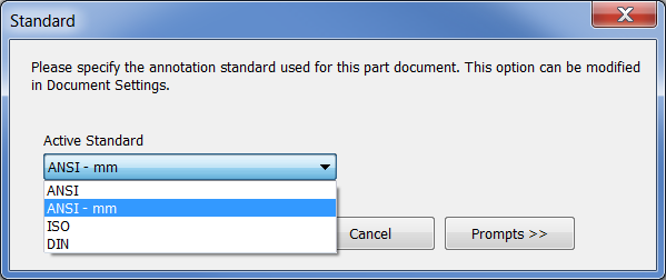

Changes to Document Settings Unit tab do not affect 3D annotations. Click Document Settings Standards tab and then specify the Active Standard to set the units. If no active standard exists the first time you use a 3D annotation command, you are asked to choose a standard.

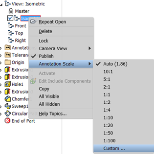

The scale of 3D annotations is independent of the Annotation Scale option in the Application Options > General tab and can be a different size in each view. Right-click a view in the browser and select Annotation Scale to set the scale.
You can also control the annotation scale of the active view by selecting the Annotation Scale drop-list in the Annotate tab > Manage panel. Use the Auto setting to let the system control the size, or choose Custom to define a scale not available in the list.

The scale of 3D annotations is independent of the Annotation Scale option in the Application Options > General tab. Right-click a View representation to set the Annotation Scale.
