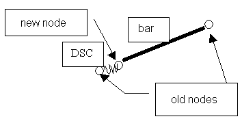

DSC Algorithm enables you to calculate a structure with releases.
For any beam, for which you defined any type of analysis, with the following releases:
The following operations are performed:
The DSC element is a 2-node element, where the nodal forces are generated according to the following formula:
Using the DSC elements lets you define elastic releases in a beam.
