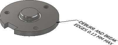

Use the text commands to add leader text and note text to the 3D model.
Leader Text is created with a single-segment leader by default. To create more leader segments, start the command, right-click, and click Single-Segment Leader to unselect the option.
Notes panel
Leader Text
Change the required values and then click OK.

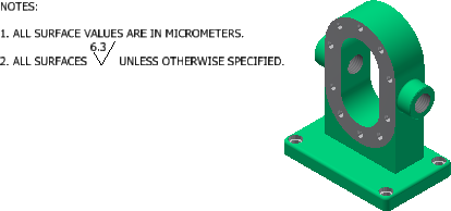

General Note
