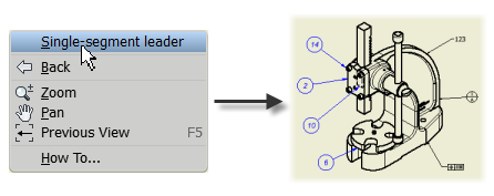

Single Segment Leader Option
Select the Single Segment Leader option to change the default procedure and create drawing annotations with a single leader segment. The Single-Segment Leader option is available for balloons, leader text, surface texture symbols, welding symbols, feature control frames, datum targets, and sketch symbols. You set the option separately for each type of drawing annotations.
