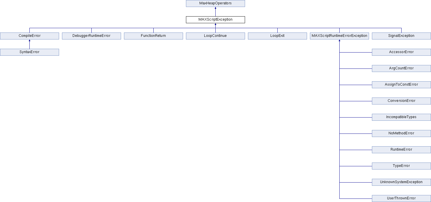

+ Inheritance diagram for MAXScriptException:
