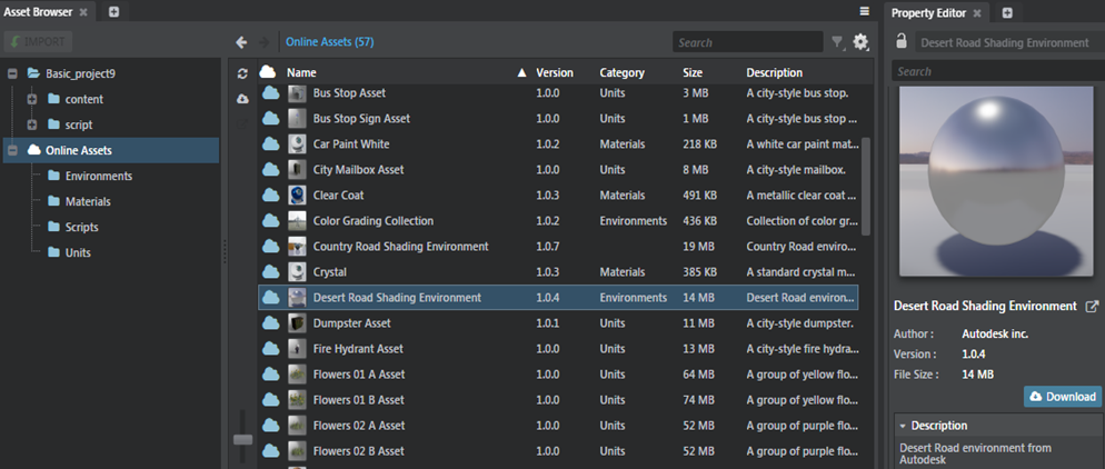

Use the Online Assets in the Tree view to browse, search and find online assets.
To download an online asset, do any of the following:
.To cancel downloading of the asset, click the yellow icon
To search for an online asset, use the Search field. The number of matching assets are listed next to the Online Assets.
To hide Online Assets from the Asset view, uncheck Online Assets in the configuration option
To view or locate a downloaded asset in your project, select an installed asset (indicated with a green checkmark) and either click
or right-click and select Locate in Project.
The online assets are not listed in the Asset Browser if the Online Assets server is disconnected from the cloud services.
