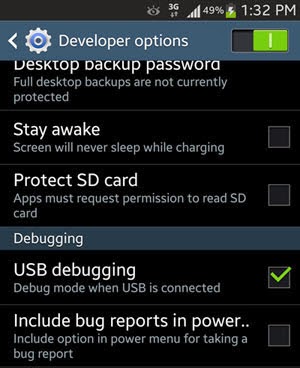

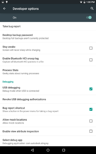

  2. Enable USB debugging on the Android device. This is typically found in the device's Settings, under Developer options. Two examples:
    If you don't see the Developer options on your device, you may need to enable them. Find the Android Build number in the device's settings, and tap the build number seven times.

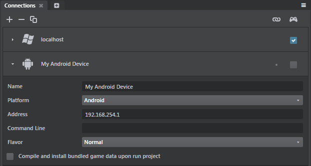

  3. In the interactive editor, use the Connections panel (Windows > Deploy and Connect > Connections) to set up a connection to the Android device:
    For details, see Using the Connections panel.
    Note: In the Address field of the Connections panel, you must enter the IP address of your Android device. You can find this in your device's settings.
When you connect to the device or run the project, the editor automatically installs the engine on the device over the USB connection, runs the engine on the device, then sends your project data to the engine.

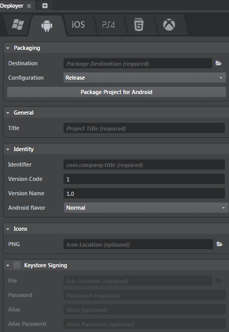

  1. In the interactive engine, open the Deployer panel (Windows > Deploy and Connect > Deployer) to the Android tab and enter the required information. (See below.)
  2. Click Package Project for Android.
The deployer creates an .apk file for your app, and copies it to the location on your computer that you specify in the Destination field.

Android deployment settings
You can set the following options in the Deployer panel for Android devices.
Packaging settings
These settings are common for all tabs. See Using the Deployer panel.
General settings
Title
The title of your project. This sets the name of the executable file for the application, and the product name for online stores.
Identity settings
Identifier
The unique process name of your application. It contains two parts separated by a dot.
Version Code
An internal version number used by Google store to distinguish between version upgrades.
Version Name
The version number, in two-part notation, that is displayed in your application, for example 1.25.
Android flavor
There are three different builds of the interactive engine for Android: a regular build, a build that plays content on Gear VR devices, and a build that plays content on Google VR devices. Use this control to choose which of these engine flavors are included in your package.
Icons settings
Browse to select your app icon in PNG format. It can be any size, but we recommend a maximum of 512x512 pixels. If you leave this empty, the Deployer uses a default Autodesk icon.
Keystore Signing settings
Keystore signing is required in order to test the generated .apk file on a device or publish it on the store. If you don't enable the Keystore Signing section, the editor automatically uses the debug.keystore that is installed at the same time as the Android SDK at %USERPROFILE%/.android/debug.keystore.
File
The location of the custom keystore file.
Password
The keystore password.
Alias
Provide the keystore alias if required.
Alias Password
The alias password if required.
For more information on keystore signing, see the Android documentation.
