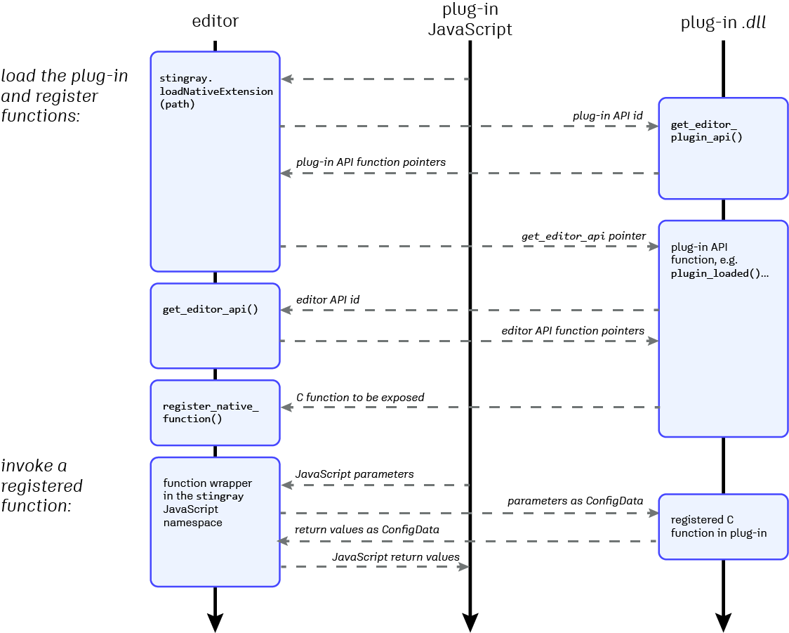

The editor's C plug-in interface is based around a consistent pattern of interactions between the editor and the plug-in. All of these interactions are based on a shared set of API definitions. Each side queries the other to retrieve the APIs that the other side supports:
The editor first queries the plug-in for its API by calling a predetermined get_editor_plugin_api function. The plug-in provides the editor with a struct that contains pointers to whatever functions the plug-in implements from their shared plug-in API definition.
When the editor calls those functions defined by the plug-in, it passes along a get_editor_api function pointer of its own. The plug-in can call that function to query the editor in return, in order to retrieve APIs that expose editor services to the plug-in. The plug-in can then call functions in those returned APIs in order to make the editor perform the tasks it needs -- typically, to register a new function to the JavaScript environment.
The following image summarizes this workflow:
This overall pattern is very similar to the way the engine interacts with plug-ins that extend its runtime capabilities. See Extend the Engine.
