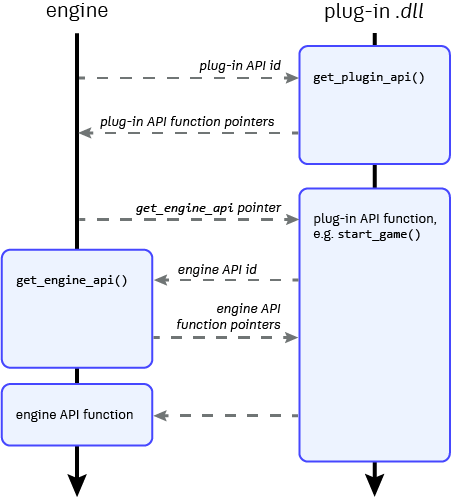

The engine's plug-in interface is based around a consistent pattern of interactions between the engine and the plug-in. All of these interactions are based on a shared set of API definitions. Each side queries the other to retrieve the APIs that the other side supports:
The engine first queries the plug-in for its API by calling a predetermined get_plugin_api function. The plug-in provides the engine with a struct that contains pointers to whatever functions the plug-in implements from their shared plug-in API definition.
When the engine calls those functions defined by the plug-in, it passes along a get_engine_api function pointer of its own. The plug-in can call that function to query the engine in return, in order to retrieve APIs that expose engine services to the plug-in. The plug-in can then call functions in those returned APIs in order to make the engine perform the tasks it needs.
The following image summarizes this workflow:
