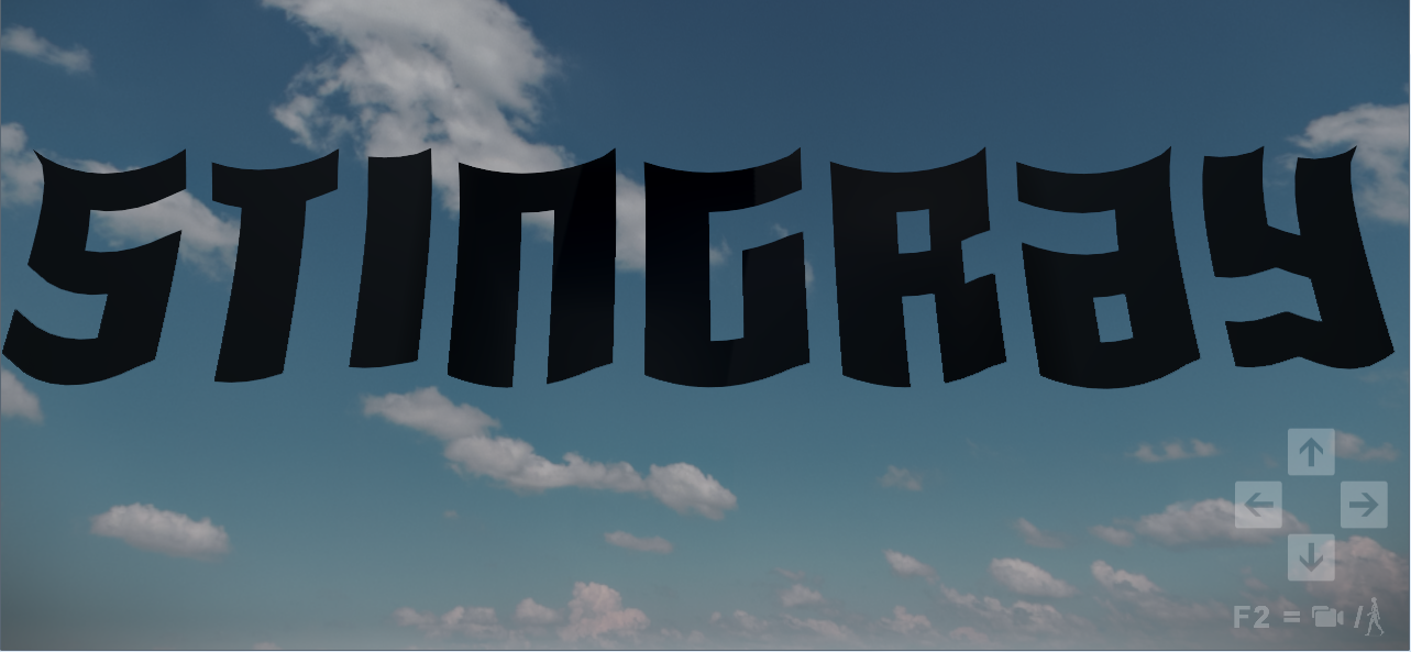

Your plug-in can use the MeshObjectApi and the RenderBufferApi together to build new meshes at runtime, and to render them in the scene. The new objects are shaded with dynamic lighting, exactly as if you had placed the objects into the scene in the editor.
For a working example that shows how a plug-in can create and render meshes on the fly, see the render_plugin/plugin.cpp file in the engine plug-in examples. This plug-in programmatically creates a mesh shaped like the word "Stingray", and deforms the mesh each frame to simulate a cloth effect:
To get this example working in your own project, first compile and install the .dll. Then, from your project's Lua script, call the stingray.RenderPlugin.create_logo() function that the plug-in adds to the Lua environment. You have to pass this function three parameters:
