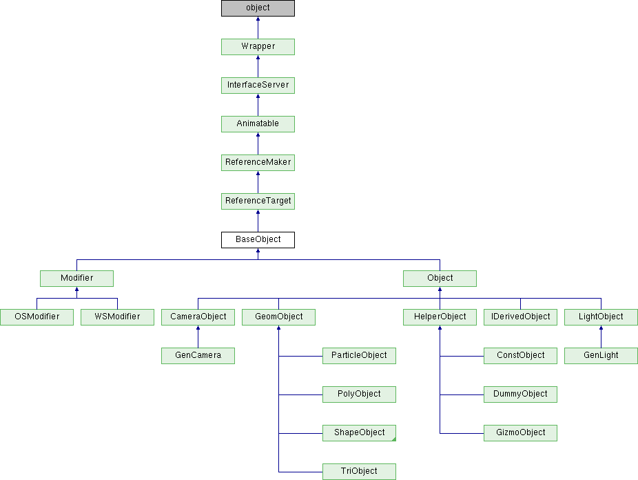

BaseObject Class Reference
The base class for anything with a representation in the 3D viewport (e.g. objects and modifiers).
