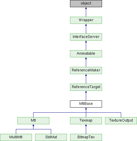

MtlBase Class Reference
Class Description
Base classes of texture maps and materials.
+ Inheritance diagram for MtlBase:
