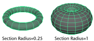

Specifies the size of the sections that make up a torus. Change this value to increase or decrease the radius of these sections.
The Twist option value specifies the twist angle of the torus. Change this value to adjust the distance around the torus in all directions.

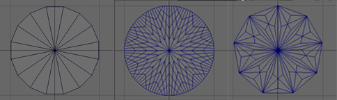

Creates a flat, filled circle with varying edge patterns.
Determines how smooth the cap is.
Determines the shape to further subdivide each slice of the disc into. Options include Quads, Triangles, Pie, Caps, and Circle.
Determines how many times the base faces are subdivided into the Subdivision mode.

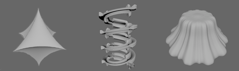

Super shapes are primitives based on cubes and spheres that are capable of creating complex organic shapes. However, due to the highly mathematical nature of these shapes, we recommend creating a base shape with the default values and then experimenting with the Random button in the associated superShape node to get a shape close to what you desire. You can then use the Attribute Editor to tweak that shape.
For more information on Super Shape options, see the superShape node.

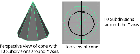

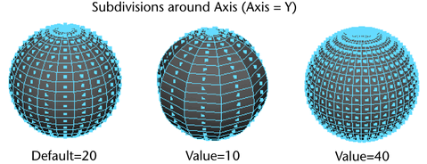

This option defines the number of subdivisions there are around the axis. This option is called Subdivisions Axis in the Channel Box and the Attribute Editor.
Increase or decrease this value to add or take away faces around the axis defined by the Axis option.

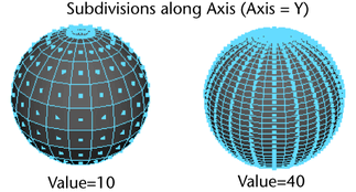

This option defines the number of subdivisions there are along the axis defined by the Axis option. Height is equivalent to the Y direction by default. This option is called Subdivisions Height in the Channel Box and the Attribute Editor. Increase or decrease this value to add or take away faces in the Axis direction.

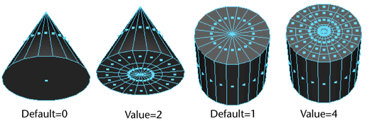

Caps are the tops, bottoms, or sides of cones, cylinders, prisms, pyramids, pipes, and helixes. This option defines the number of subdivisions around the origin of the primitive caps. This option is called Subdivisions Cap in the Channel Box and the Attribute Editor. Increase or decrease this value to add or take away faces around the caps.
This option allows you to create a round surface for the cap. Your Subdivisions Cap value must be one or greater to see the round cap effect. This option applies to the Cylinder, Cone, Pipe, and Helix primitives.
