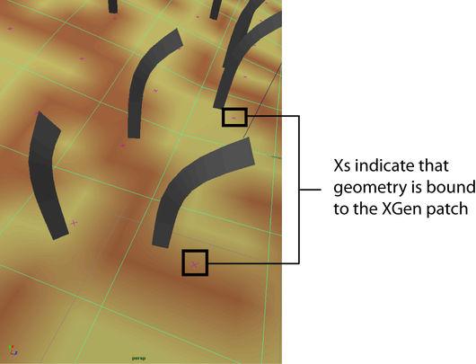

. In the scene view, areas bound to XGen patches display with a magenta-colored X at the center of the geometry faces. Patches do not have attributes to modify. You can change which polygon faces bind to the patch by using the
