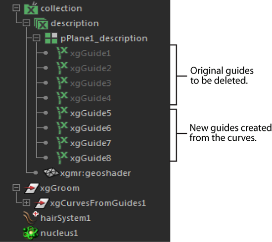

When on, this option maintains a dynamic connection between the curves and the converted guides so that the guides inherit the curve animation.
Maya converts the dynamic curves to new guides and hides the original guides. The new guides inherit the curves dynamic properties.
