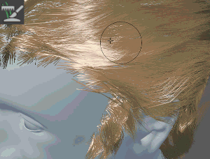

| Adjust brush size | B + drag or middle mouse button (MMB)-drag left/right | B + drag or MMB-drag left/right | The tool cursor resizes larger and smaller as you drag. |
| Adjust brush size from 0 | B + MMB-drag left/right or Ctrl + MMB-drag left/right | B + MMB-drag left/right or Ctrl + MMB-drag left/right | The tool cursor resizes larger and smaller as you drag. |
| Adjust brush strength | M + drag or MMB-drag up/down | M + drag or MMB-drag up/down | The brush strength indicator lengthens or shortens as you drag. |
| Adjust brush strength from 0 | M + MMB-drag up/down or Ctrl + MMB-drag up/down | M + MMB-drag up/down or Ctrl + MMB-drag up/down | The brush strength indicator lengthens or shortens as you drag. |
