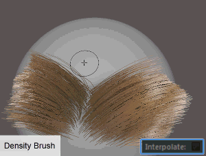

Density ![]() |
Adds, removes, or redistributes hairs (units/ face) on the areas under the brush radius. Use this tool to thin or thicken hair in specific areas as needed. Density brush strokes set density values locally on the surface of the mesh. These values are saved to the description_base node rather than to sculpt layers. This means the Density brush cannot be layered or blended using sculpt layers. See description_base node attributes. See also Control the density of the hairs and Density Brush Settings. |

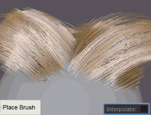

Place
Places single hair strands on the surface of the character mesh. Use this tool when you need to precisely position individual hairs. See Place Brush Settings. |

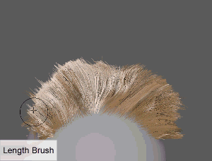

Length ![]() |
Lengthens or shortens hairs uniformly without modifying their shape. You can set minimum and maximum values to limit the final length applied by the brush strokes. This brush scales the hairs length locally. You can scale hair globally using the Scale modifier. |

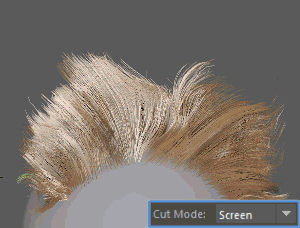

Cut ![]() |
Trims hairs that intersect with the brush radius. See Cut Brush Settings. |

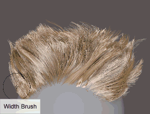

Width ![]() |
Scales the width of hairs without modifying their shape. This tool is also useful for thinning hair and for smoothing transitions along hairlines. The Width brush sets width per-CV values on the hairs. These values are saved to the descriptionShape node rather than to sculpt layers. This means Width cannot be layered or blended using sculpt layers. See descriptionShape node attributes. e See also Width Brush Settings. |

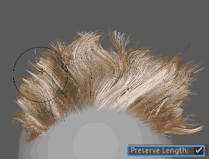

Changes the orientation and bend of hairs in the direction of the brush stroke. Hairs in the brush radius are affected as you drag. This tool is useful for both sketching out the base shape and style of the hair as well as for making subtle final touch-ups to the groom. See Comb Brush Settings. |

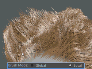

Smooth ![]() |
Applies smoothing to hairs in the brush radius by averaging the CV offsets. This creates a hair straightening effect in the direction of the brush stroke. You can smooth the hairs globally, which affects all hairs in relation to each other, or locally, which applies the effect to the hairs individually. Use this tool to straighten and blend the orientation of hairs, and to create smooth transitions between long and short hairs. Press Shift activate the Smooth tool when another interactive groom tool is already active. |

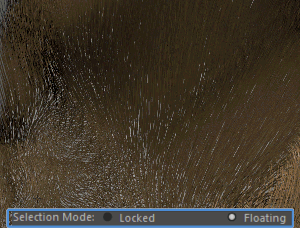

Creates hair clumps by pulling hairs towards a centralized hair within the brush radius. Clumping hair can break up its uniform flow, making it look more realistic. The clumping effect is additive with each stroke. The more you groom an area, the greater the clumping effect. Use this brush in Locked mode to create hair clumps from a locked selection of hair. Use it in Floating to clump hairs along the stroke as the brush moves across the surface of the mesh. See Clump Brush Setting. |

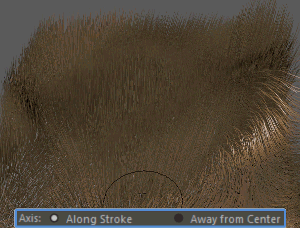

Part ![]() |
Pushes hairs away from each other either by rotating them away from the axis or by pushing them away from the center of the stroke. Use this tool for creating part lines or breaking up the flow of hairs in fur, such as where skin folds and rubs together. See Part Brush Settings. |
