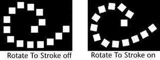

Determines the alignment of brush shapes that are not uniformly round. Turn this option on to align the stamp shape relative to the direction you move the brush. Turn this option off to align the stamp shape relative to the up vector. The stamp shape retains its orientation when you change the view.

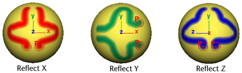

Turn on this checkbox for reflections.
(The Reflection option must be checked to use this option.)
By default the reflection axis is the center of the selection's bounding box. For the reflection axis to be the origin, turn on this checkbox. This is useful if the model is not entirely symmetrical; for example, a creature with a tail that is curled to one side.
Check the axis you want to reflect in. The origin for reflection is the center of the selection's bounding box.

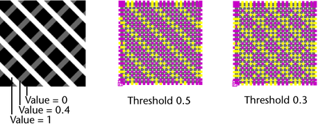

For the Paint Selection Tool only. Defines the minimum value to be affected by the tool selection type. For example, if you set the Paint Operation type to Select and the Threshold to be 0.5, Artisan selects vertices that are mapped with an imported value equal to or greater than 0.5.

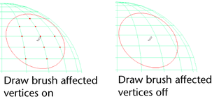

Turn this on to highlight the vertices the Sculpt Geometry Tool is affecting as you pass the brush over the selected surface. For more information on the Sculpt Geometry Tool, see Sculpt Geometry Tool overview.

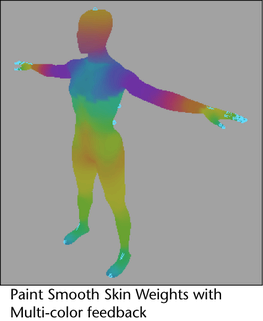

For Paint Skin Weights Tool only. Turn on this setting to view the distribution of painted skin weights on your bound geometry as multi-color feedback. The colors that appear on your bound pieces of geometry correspond to the colors of their skeletons’ joints and bones, and they indicate the areas of skin each of their joints affect. You can view Multi-color Feedback in the scene view when in Vertex mode or when using the Paint Skin Weights Tool.

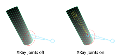

Turn this option on to have wireframe joints display on top of the mesh you are painting. This lets you view the mesh in a shaded mode and easily select wireframe Influence objects without switching between wireframe and shaded views.
