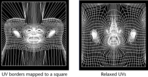

Optimizing UVs evens out the spacing between UVs on a mesh, fixing areas of distortion (overlapping UVs). For example, you can untangle interior UVs in combination with the Map UV Border command. You can begin by mapping the UVs to a border (either a square or a circle), and then relax the UVs to even out the spacing of the UVs.
To relax UVs using the Optimize command

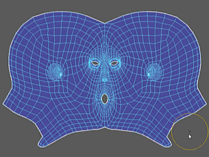

Identify UV distortion.
This shades areas of your UV mesh that are squashed or stretched, making it easy to identify areas that you need to optimize.
