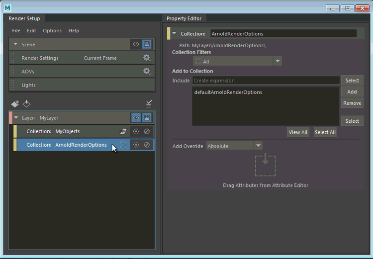

If you have added fog to your scene by connecting an aiFog to the Atmosphere attribute of the Arnold for Maya Render Settings, you can disable the fog for specific render layers by doing the following:
Select All from the Collection Filters drop-down list to ensure that the node is not filtered out.
Leave the connection override unconnected to disable fog in your render layer.
