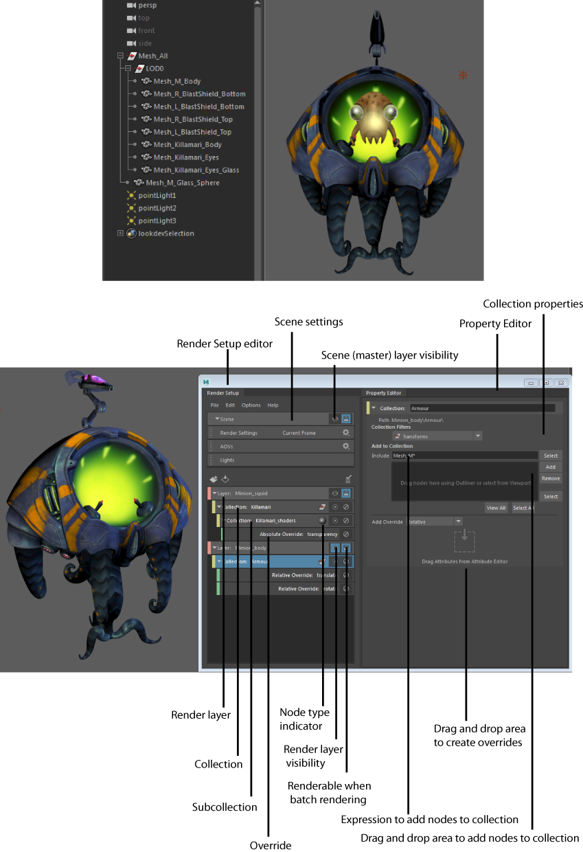

Click
on the status line to open the
Render Setup editor. The
Render Setup workspace window appears, with the
Render Setup editor on the left and the
Property Editor on the right. The
Render Setup editor allows you to create layers, collections and overrides, while the
Property Editor allows you to set their corresponding values. In addition, the
Render Setup editor allows you to access your scene (master layer) settings via its
Scene tab.
If you select the Rendering - Standard or Rendering - Expert workspaces, the Render Setup and Property Editor windows are automatically docked for you.

In this example, the first layer has a collection that contains the squid character. An override is applied on the Transparency attribute of the shaders; thus a Killamari_shaders subcollection is automatically created. The second layer has a collection that contains the armor of the Minion character, and a relative override is applied to its Rotate attribute, and another relative override is applied to its Translate attribute.
