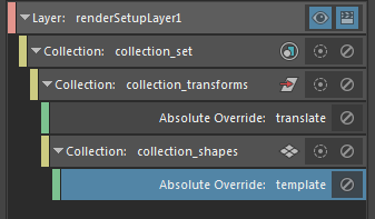

When you add a set to your collection and set the Collection Filters drop-down list to Sets, only the set itself is included. Its members are not included.
Therefore, when you create an override on this collection, you can only override attributes on the Set. You cannot override attributes on the transform or shape node of the set members.
In this example, set1 contains the sphere's transform node.
You cannot drag and drop a Transform attribute to the collection_set Attribute Editor to create an override on the pSphere1 node.
To create an override on the sphere transform node or shape node, follow this example:
