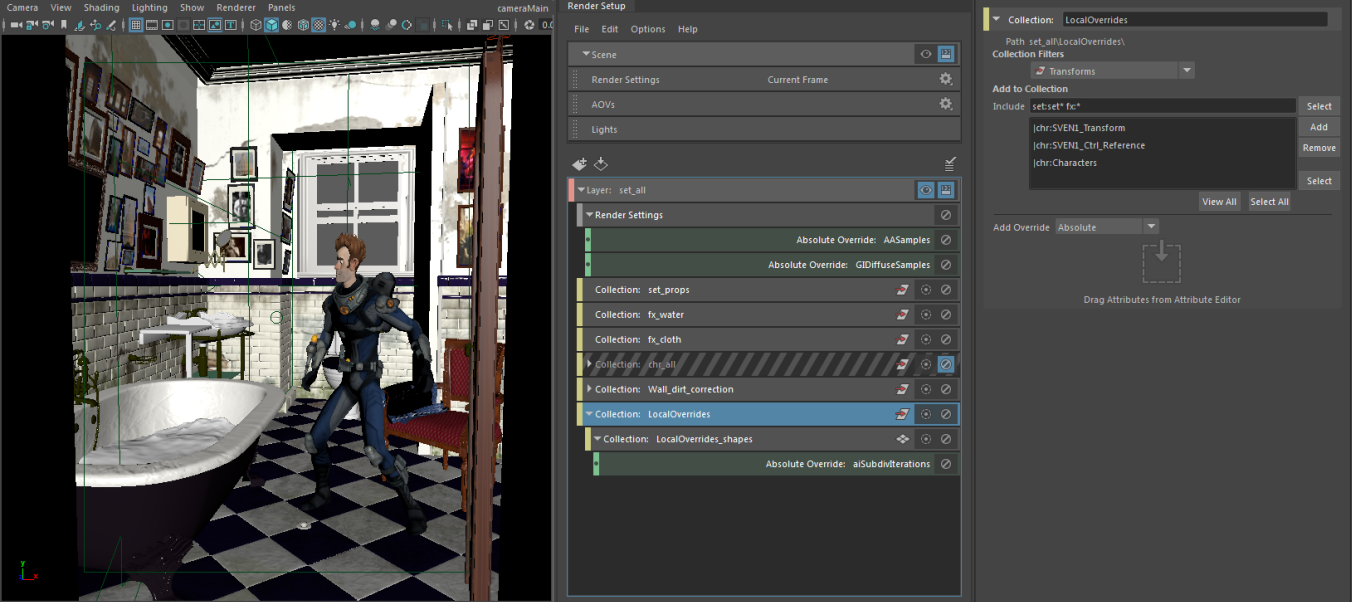

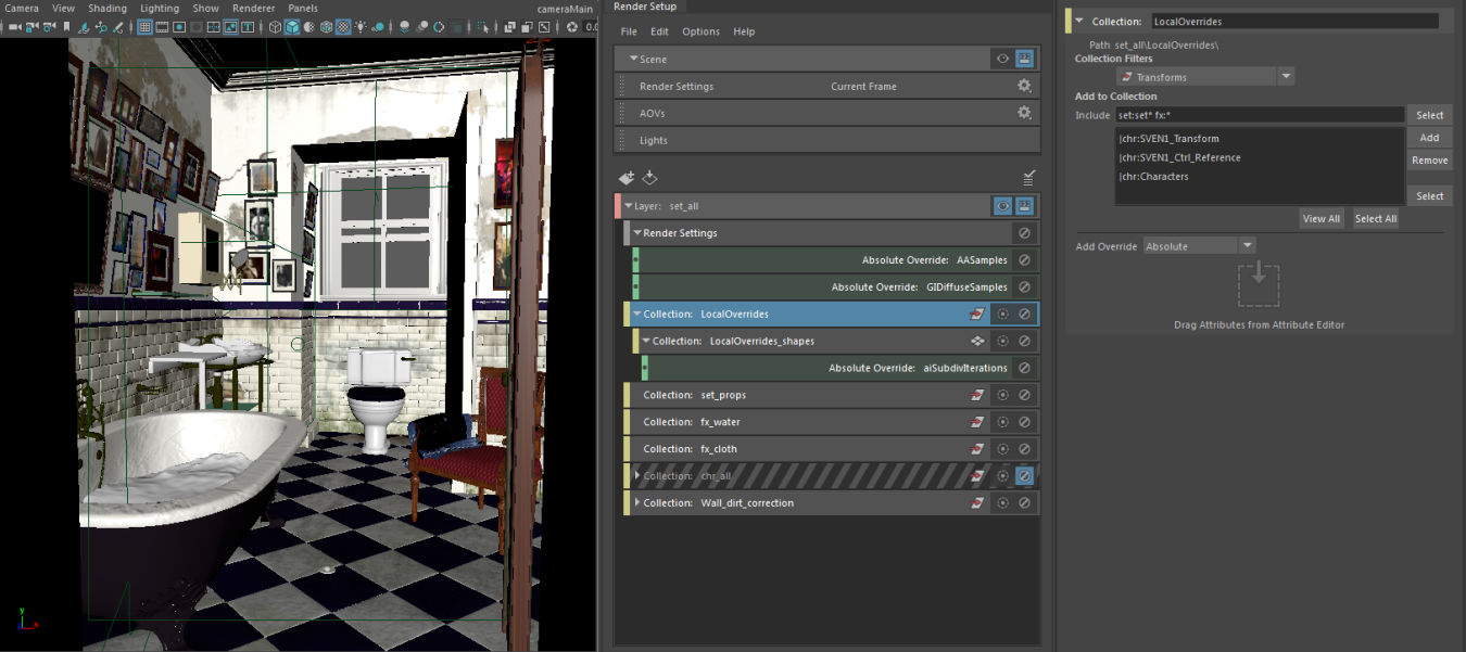

Adding a Local Override collection to a Render Setup where a collection may be disabled
Because collections are interpreted top-down, this collection should be the top-most collection in your layer so that it does not take precedence over other collections and overrides in your layer.
In this example, the character belongs in two collections: LocalOverride and chr_all.
If LocalOverride appears on top and chr_all appears below, and chr_all is disabled, then chr_all is not rendered. This is the correct behavior.
However, if chr_all appears on top and LocalOverride appears below, then your character will appear in your render, even though you have disabled the chr_all collection. This result is incorrect because the LocalOverride collection includes the character and is enabled.
