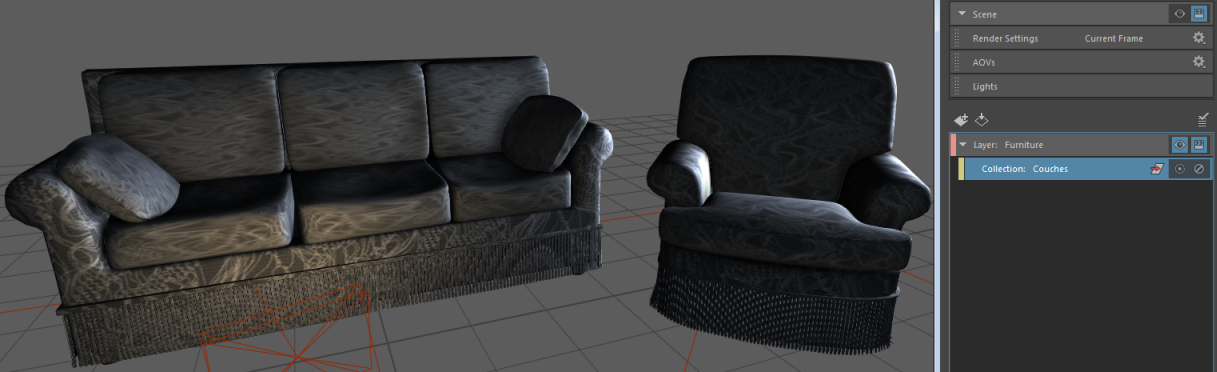

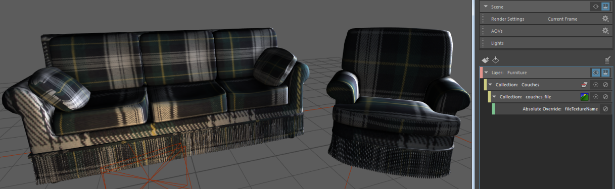

In this example, the couches are assigned to a lambert, which is mapped to a greyish texture. To assign the couches to a plaid texture instead, you can do as follows:
A file node subcollection is created, as well as a corresponding file texture name override.
Enable or disable the file node override to switch between the two textures.
