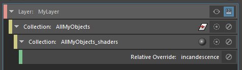

If you have a scene with 100 objects, each with a different shader applied, and you need to make each of the shaders 10% brighter, you can do as follows:
A shaders subcollection is automatically created beneath your object collection, as well as a corresponding Incandescence override.
Select the override and adjust the Incandescence attribute in the Property Editor. All of the shaders included in your collection become brighter as a result.
This eliminates the need for you to adjust each shader individually.

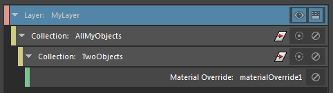

If you have a scene with 100 objects, each with the same shader applied, and you need to change the shading on two of these objects, do as follows:
Right click this subcollection and select Create Material Override.
Select the override. In the
Property Editor, click the
button to assign a different material; or drag and drop an existing material from the
Hypershade to the
Property Editor.
The viewport updates to show that only the two objects that are members of the second collection are assigned the new material.
In this case, because all the objects share the same shader, you cannot override an attribute on the shader as you did in Example 2. Otherwise, all the objects will have the same override applied. You should create a material override and not a shader override, since shader overrides are not collection specific, and are applied to all objects in the same layer that share the same initial shader assignment.
For more information regarding material and shader overrides, see Override the material applied to the objects in a collection.

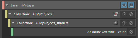

If you have 100 characters in your scene, and the characters are all wearing t-shirts that are assigned to different shaders, but you want to map all of these t-shirts to a new texture, you can do as follows:
A shaders subcollection is created, as well as a corresponding color override.
Select the color override and click the
button in the
Property Editor to connect to a new texture.
For more information, see Connect a network to an attribute using a value override.

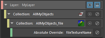

If you have 100 characters in your scene, and the characters are all wearing t-shirts mapped to one texture, but you want to map all of these t-shirts to a new texture, you can do as follows:
A file node subcollection is created, as well as a corresponding file texture name override.
