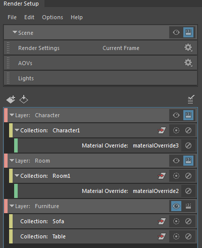

Only the currently visible render layer, denoted by the icon, is rendered into the Render View via interactive rendering. This is true regardless of whether the layer is set to renderable via the icon. This render result is saved into the /tmp folder of your image output directory.
In this example, the masterLayer, Character and Room layers are rendered during batch render as they are denoted as renderable by the icon.
Only the Furniture layer is rendered during interactive rendering as it is set to visible. This is true even though the layer is set to non-renderable for batch rendering.
