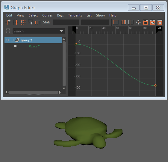

Editing the turntable animation
You can modify the turntable's rotation in the Graph Editor. Select the group that contains the turntable camera in the Outliner; the animation curve is shown in the Graph Editor as Rotate Y.
