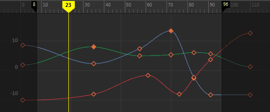

Maya's Graph Editor is an updated version of the legacy Maya Graph Editor, giving you a more intuitive approach to manipulating animation curves and keys in your scene.
The Graph Editor is presented as graph view of scene animation so you can create, view, and modify animation curves various ways. For example, you can control interpolation between keyframes, extrapolation of curves, and change animation curves value and timing by altering the shape of animation curves using tangent handles.
Note: While the Graph Editor's color scheme is designed for high visibility, you can customize the colors in the Color Settings.

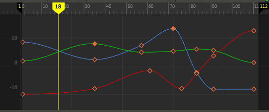

Pan and Zoom in the Graph Editor Same as Viewport navigation:
  • Pan: press Alt or Option (Mac OS X) key and middle-drag.)
  • Zoom: press Alt or Option (Mac OS X) and drag or right-drag. Zooming is centered based on the location of the mouse cursor.
Zoom on a curve Select the animation curve (see To select a curve,below) and click F to frame the selection.
Resize the Playback range On the Time Ruler, click the edge of the dark region and drag to change the playback range. Stretch the playback range in the time view by dragging the flags on the Time ruler.
Scrub animation Drag the Current Time Marker.
  • To scrub along the Time ruler at the top of the Graph view, drag the Current Time Marker left or right.
  • To scrub in the Graph view (below the Time ruler), press K to release the cursor lock. (The cursor is locked from scrubbing in the Time view to prevent moving keys/curves unintentionally.)

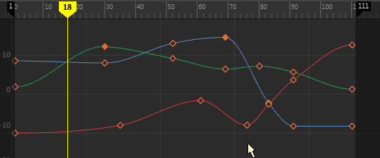

Move multiple keyframes in time without changing the attribute value Drag-select the keyframes to move. Shift-middle-drag the frames left or right.
Change views Absolute view: Press 1
This view is the default.
Stacked view: Press 2
Normalized view: press 3
Select View > Renormalize to revert back.
