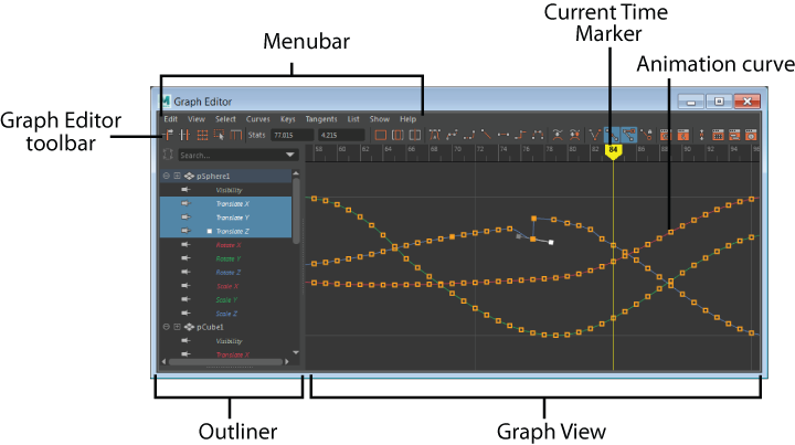

Graph Editor interface overview
The Graph Editor includes a toolbar, outliner and a graph view.
Graph Editor menu bar
The Graph Editor menu bar contains tools and operations for manipulating animation curves and keys within the graph view of the Graph Editor.
Graph Editor toolbar
The Graph Editor toolbar contains icons for commonly-used options that are found in the menus and by right-clicking the Graph Editor Interface. For descriptions of what these icons do, see Graph Editor toolbar.

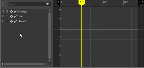

Graph Editor Outliner
Like the Maya Outliner, the Graph Editor Outliner shows a hierarchical list of all viewable channels in the scene in outline form. You can expand and collapse the display of branches in the hierarchy; lower levels of the hierarchy are indented under higher levels. The Graph Editor Outliner is where you select which animation curves to display in the Graph View.
You can use the Search function to locate channels in the Graph Editor the same way you can in the Maya Outliner. See Search and filter nodes for more information.

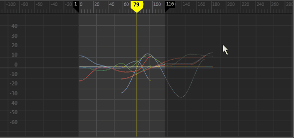

Graph Editor Graph View
The Graph Editor Graph View displays animation curve segments, keys, and key tangents. You can pan and zoom through the graph view using the same navigation hotkeys as the Maya Viewport and scrub animation along the Time ruler at the top by dragging the Current Time Marker left or right. (To scrub in the graph view below the Time ruler, press K to release the cursor, which is locked to prevent unintentionally moving keys/curves.)

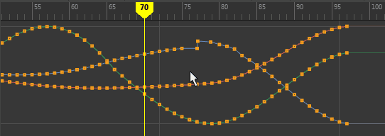

Graph Editor current time marker
The Graph Editor Current Time Marker indicates the frame currently shown in the Viewport. Drag it along the Time Ruler at the top of the Graph View to scrub through animation.
The Time Marker is locked so you cannot scrub through the Graph View. This prevents accidental dragging of curves. To unlock the Time Marker so you can drag in the Graph View, press K at the same time as you drag.
