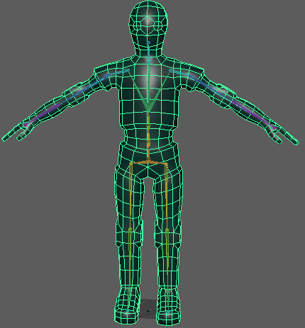

After binding skin, you can use the Paint Skin Weights Tool to edit the influence of joints in an intuitive manner. For more information, see Painting smooth skin point weights.
Available only for Geodesic Voxel binding (when Bind Method is set to Geodesic Voxel).
Controls how rigid the bind is applied to the geometry. A value of 1 creates a more rigid bind, while 0 produces a smoother bind. (The default value is 0.2)
Available only when Bind Method is set to Geodesic Voxel.
Increases the precision of the voxelization. Maya calculates the weighting based on the voxelized volume. Depending on the resolution sections of the mesh may become connected in voxel space, which can result in binding artifacts (similar to those that occur with the Closest Distance or Closest in Hierarchy methods).
The following images show a mesh voxelized at two different resolutions. In the first image, since a coarse resolution is selected, knee and hand voxels become connected. This results in deformation of knee geometry when the arm moves, and so on.
At a finer resolution (see below), the hand and leg stay independent, yielding a higher quality bind.
When on, performs a post-validation on the voxels. Activated by default, you can disable it as it is not required and causes additional processing time. However this can be a useful diagnostic tool for more complex geometry. See also Degenerate geometry.
