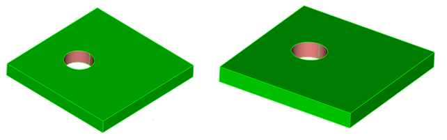

- Increase or reduce the thickness of the part,
- Change the diameter of a cylinder or a circular section,
- Move an entire section, such as the position of ribs, holes or bosses, as shown in the image,
- Preserve fillets and chamfer by keeping the same radius.
