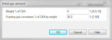

To simulate microcellular injection molding using a chemical blowing agent, select Chemical blowing agent (CBA) in the process settings.
Once you have selected a chemical blowing agent, edit the value associated with the chemical blowing agent in the Initial gas amount dialog.
